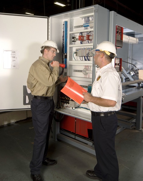

Occasionally, a listed or labeled product doesn’t look quite right or has obvious violations. This is when electrical inspectors will notify the NRTL or FEB. The testing organization can determine if it is a counterfeit label, if the equipment was modified, or if a manufacturer is incorrectly manufacturing the product. In any case, the NRTL or FEB has a process to review, evaluate, and stop problems in the future.
In those cases, where an item with violations is holding up the opening of a business, working with an FEB that has the ability to nondestructively test in the field can provide significant time savings, especially with equipment that has been modified, refurbished, or relocated. Such changes normally void the NRTL’s approval of that product, and an employer’s use of it in the workplace violates the OSHA standard requiring the approval.
The FEB provides field label services paid for by one of the parties involved—typically the manufacturer or the installer—to determine if the equipment is compliant in the specific installation. Choosing the right FEB during this critical time is essential.
You’ll want an organization that has a geographically dispersed network of highly trained, safety-certified technicians, along with engineers who know the applicable safety standards for your class of equipment and the reasons behind the standards. Working with engineers who are regular participants in the codes and standards-making processes offers added benefits.
It’s important that an FEB is approved by AHJs from around the country and is recognized in the industry. This makes the process of getting final approval of equipment much smoother. Local jurisdictions know that if the recognized FEB’s label is applied, the job was done right. Working with an experienced FEB inspires confidence and assures others that the equipment was properly inspected and that any discrepancies have been corrected.
A good place to start in the search for an FEB is IAS, which is a nonprofit corporation that has been providing accreditation services since 1975. IAS makes sure that an FEB’s experience, practices, equipment, and processes meet the stringent NFPA 790 and 791 standards, as well as other IAS requirements. The accreditation provides objective evidence that an FEB operates at the highest level of ethical, legal, and technical standards.
The importance of ensuring proper installation and operation of electrical equipment cannot be overstated. After all, many organizations already embrace safety compliance and invest considerable resources in order to protect employees, the environment, and the company as a whole.
Keep in mind that not all testing companies have the competency or experience needed to help you properly protect this investment, so scrutiny is needed when choosing the third-party testing organization that is right for you. An accredited FEB that offers the flexibility of field testing may just be the solution you need to ensure safe operation, get an inspector’s “red tag” removed from your equipment, and get back to business.
