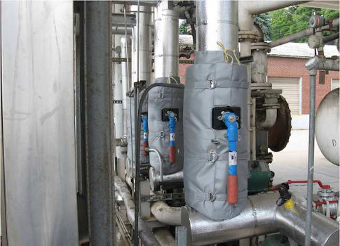

Designs for easy removal and replacement
One very useful solution is advanced insulation systems that are highly effective yet allow easy removal and replacement for periodic inspection or service. One provider of these systems is Shannon Enterprises, manufacturers of Insultech blanket thermal and acoustic insulation systems. Shannon manufactures a wide range of custom insulation products, including insulation packages for steam and hot water pipes and devices of all type. Commonly insulation for each steam device is custom-fitted to allow for piping, sensors, valve stems, etc. This fitted insulation is designed for quick removal and replacement to allow for inspection or service, and fits around data links such as steam trap monitoring systems. Three additional benefits of quality insulation are more comfortable working conditions, less pipe noise, and reduced risk of personnel burns.
