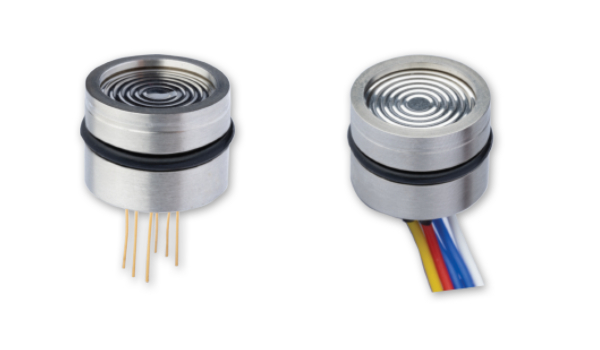

CUI Devices’ Sensors Group today announced the addition of pressure sensors to its product portfolio. Offering absolute, gauge, and sealed gauge pressure types, these pressure sensors based on piezo technology feature analog or digital I2C outputs and pressure ranges from 0 kPa up to 100 MPa. All PS series models are temperature compensated and housed in stainless steel construction with an O-ring seal, making them ideal for a variety of applications, including industrial, scientific, medical, white goods, and more. These pressure sensors further offer excitation ratings of 3.3 V, 5 V, 10 V, or 1.5 mA and 3-wire, 4-wire, 5-wire, or 6-pin terminations. All models feature 19 mm diameters and heights of 14 mm, while carrying accuracy ratings as low as ±0.2% and operating temperature ranges from -40 up to 125°C.CUI Devices’ pressure sensors are available immediately with prices starting at $38.28 per unit at 100 pieces through distribution. Please contact CUI Devices for OEM pricing. For helpful resources and tools on sensors, check out our Resource Library that houses a range of blog posts, videos, and more.
