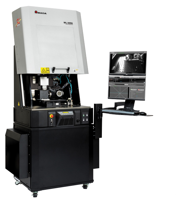

AMADA WELD TECH Inc. announces the new WL-300A precision laser welding workstations, configured for continuous wave (CW) or quasi-continuous wave (QCW) fiber lasers. Typical applications include welding of metals, and select plastics, particularly for aerospace applications.
The WL-300A incorporates a laser, motion, cameras, a process monitor, and other accessories. The system is a CDRH Class 1 workstation designed for low to medium-volume production with an operator load/unload of the parts. It is a smaller, standardized version of the company’s highly configurable Delta workstation and is based on the space saving compact platform design of the WL-P300A. The standalone enclosure includes an ergo-arm for computer and display.
This product comes standard with an air-cooled CW or QCW fiber laser integrated into the base. Optionally, a floor-standing LF model laser could be integrated and used with the workstation.
Beam delivery is through a galvo scanning head. There are two options for lenses with 163mm (70 mm x 70 mm field size) and 330 mm (188 mm x 188 mm field size).
Up to 4 axes of motion can be used within the enclosure and are controlled through marker motion. The Z axis is standard for all models and has a 200 mm stroke. The XY table has a 150 mm x 150 mm stroke. There are various options for rotary stages with the most common being a 1:1 belt-driven device.
