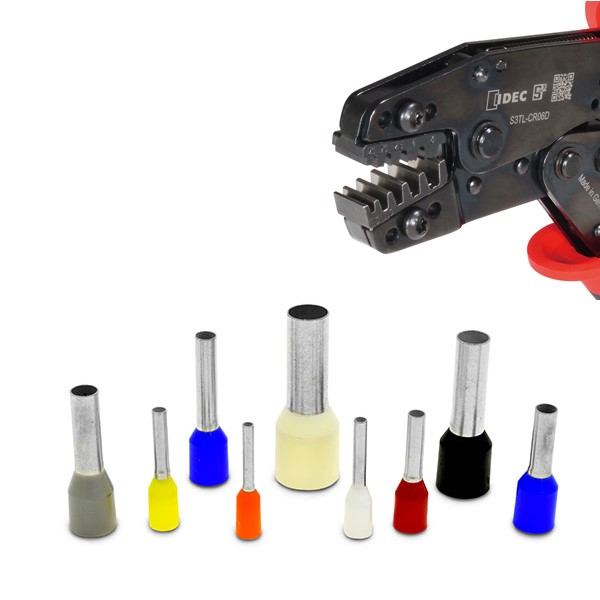

IDEC Corporation has released a complete product line of S3TL series ferrules, wire strippers, crimpers, and screwdrivers. Properly installed ferrules provide dependable wire terminations to both screw and push-in terminals, but installers and technicians need suitably rated parts and associated tools for making these connections, which are provided by this new line of products. A ferrule is a metal tube crimped over the end of a stripped stranded wire to secure the strands together, preventing stray strands, increasing conductivity, and decreasing resistivity. Ferrules provide improved mechanical and electrical connections as opposed to using just bare wire. Ferrule use is identified by UL 508A section 29.3 “wiring methods”. The IDEC S3TL ferrule product line includes various sizes accommodating wire gauges from AWG 26 to AWG 8, each with one or two wires, depending on part number. Each ferrule incorporates an electrically insulated cover, which is color-coded using the German Weidmüller standard, for easy recognition by installers. The ferrules are UL 486F certified when used together with S3TL series crimping tools. For optimal and efficient installation, IDEC offers two wire strippers (6-10AWG and 10-28AWG ranges), three crimping tools (6-10AWG, 10-24AWG, and 12-30AWG ranges), and three insulated screwdrivers (60mm, 75mm, and 100MM shaft lengths). The strippers and crimpers are ergonomically designed for comfortable function with minimal required force.
