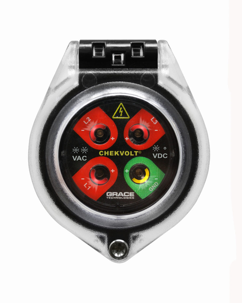

Performing Lockout/Tagout (LOTO) safely requires the answer to one question; is there voltage? NFPA 70E/CSAZ462 requires an absence of voltage test to verify an electrically safe work condition. The traditional process poses arc flash and shock hazards to comply with NFPA 70E Article 120.5: Process for Establishing and Verifying an Electrically Safe Work.
The ChekVolt allows you to test absence of voltage and provides voltage presence indication; all without opening the enclosure door. Permanent Electrical Safety Device (PESD) users report LOTO procedure time reductions of 35-40 minutes. ChekVolt pays for itself after 6-8 LOTO procedures from time savings alone.
This touch-safe, compact PESD features voltmeter-compatible test points and redundant LED voltage presence indication rated up to 1000 VAC/VDC. The ChekVolt is quickly installed through a single 30mm knockout and includes four lead wires potted in the construction–making LOTO in even the harshest environments safer, smarter, and more productive.
