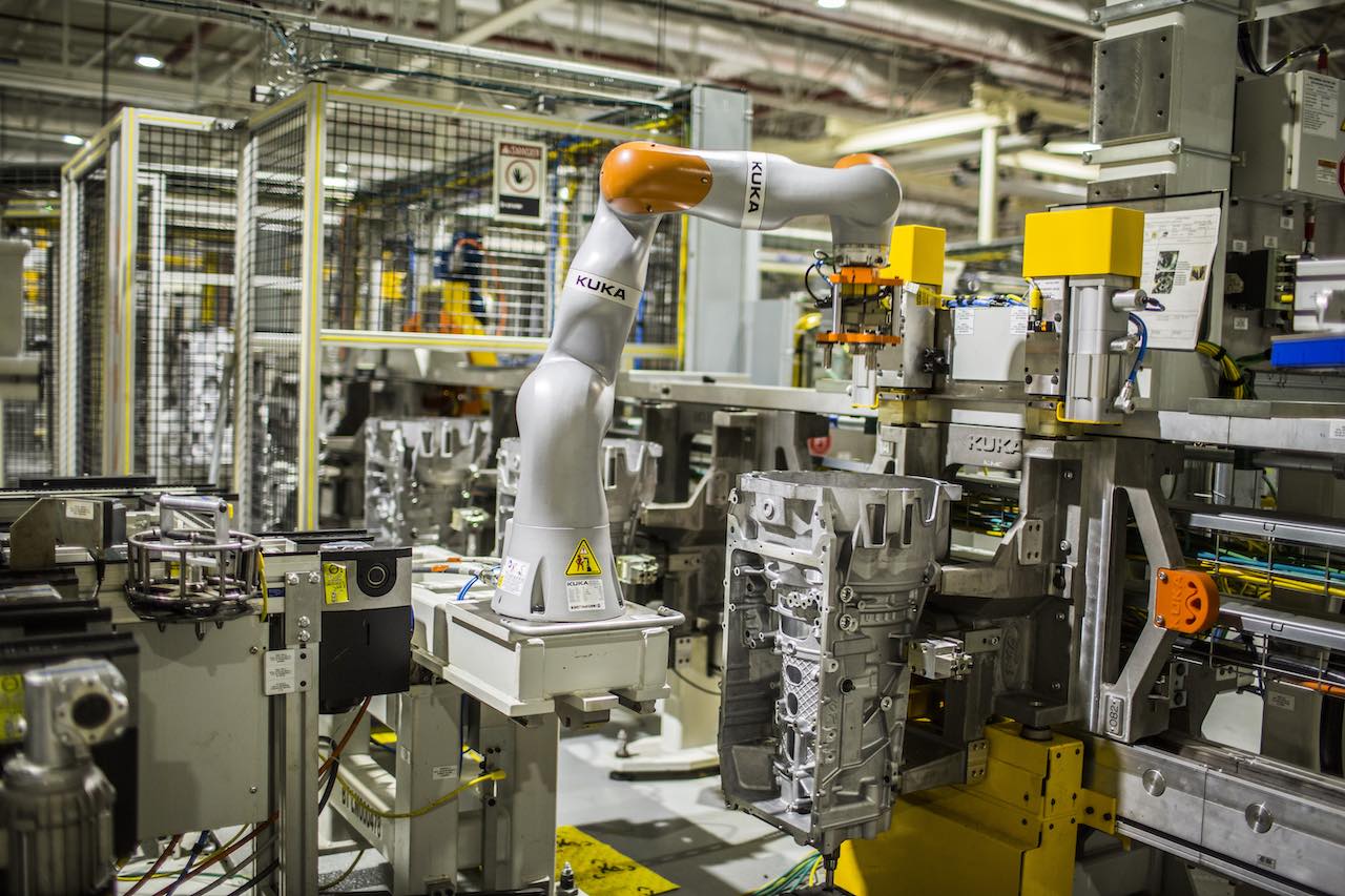

Probabilistic roadmaps (PRMs) help to create collision-free paths for collaborative robots and refers to the set of random points in the configuration space within which the planner knows the collaborative robot can safely move.
Clear, free workspaces are rare in warehouses, production facilities, and other industrial spaces where collaborative robots are used. Sometimes, collaborative robots are pushed into work cells that are smaller than originally planned. On occasion, there’s nowhere else to stack materials except for in an area closer to a collaborative robot than originally planned.
