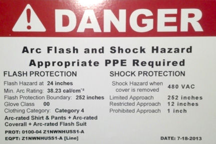

Arc flash safety begins with a focus on daily work-practice fundamentals and a complete vision on OSHA guidelines for electrical safe-work practices. Above all other precautions, the most effective way to completely avoid the dangers of arc flash is simple: de-energize all electrical circuits before working on them. In addition, any equipment that operates at 50 V or more should carry a warning label that clearly instructs users what protective gear should be worn when using it.
