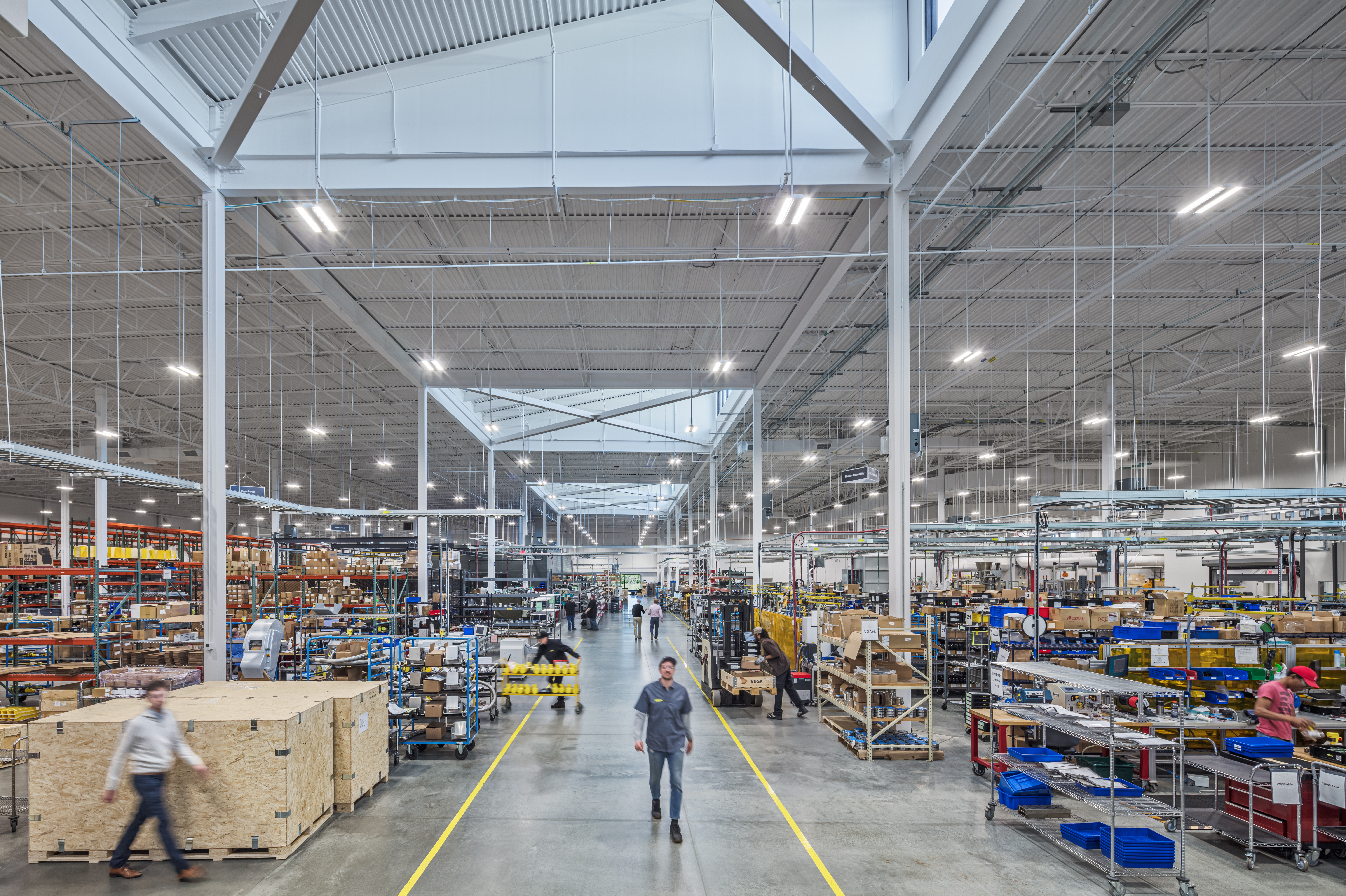

Traditional manufacturing environments aren’t designed for workers
Traditional industrial facilities are designed around the production lines they house and the products and materials they produce. Their layout and design focus on the machinery and processes required for production, with little consideration for the human element. Non-manufacturing spaces, such as break rooms, lockers and offices, are afterthoughts crammed into leftover corners so as not to interfere with the assembly line. It’s common to find the cafeteria a 15-minute walk away from the assembly floor for workers with only a 35-minute lunch break.
The perception of the dark, dingy factory is well-earned. Assembly floors are often artificially lit, windowless areas with poor ventilation. This industrial aesthetic reinforces manufacturing’s reputation as hard, dirty work. Companies have difficulty attracting and retaining workers when candidates and employees experience an environment that embodies these negative stereotypes. A quarter of Soter Analytics’ “Gen Z Industrial Work Report” respondents believe manufacturing work conditions are unsafe. The same report also found that 26% of respondents consider industrial work a short-term option, not a career choice. These responses underscore the need and opportunity to design manufacturing facilities that emphasize worker well-being and experience alongside production efficiency.

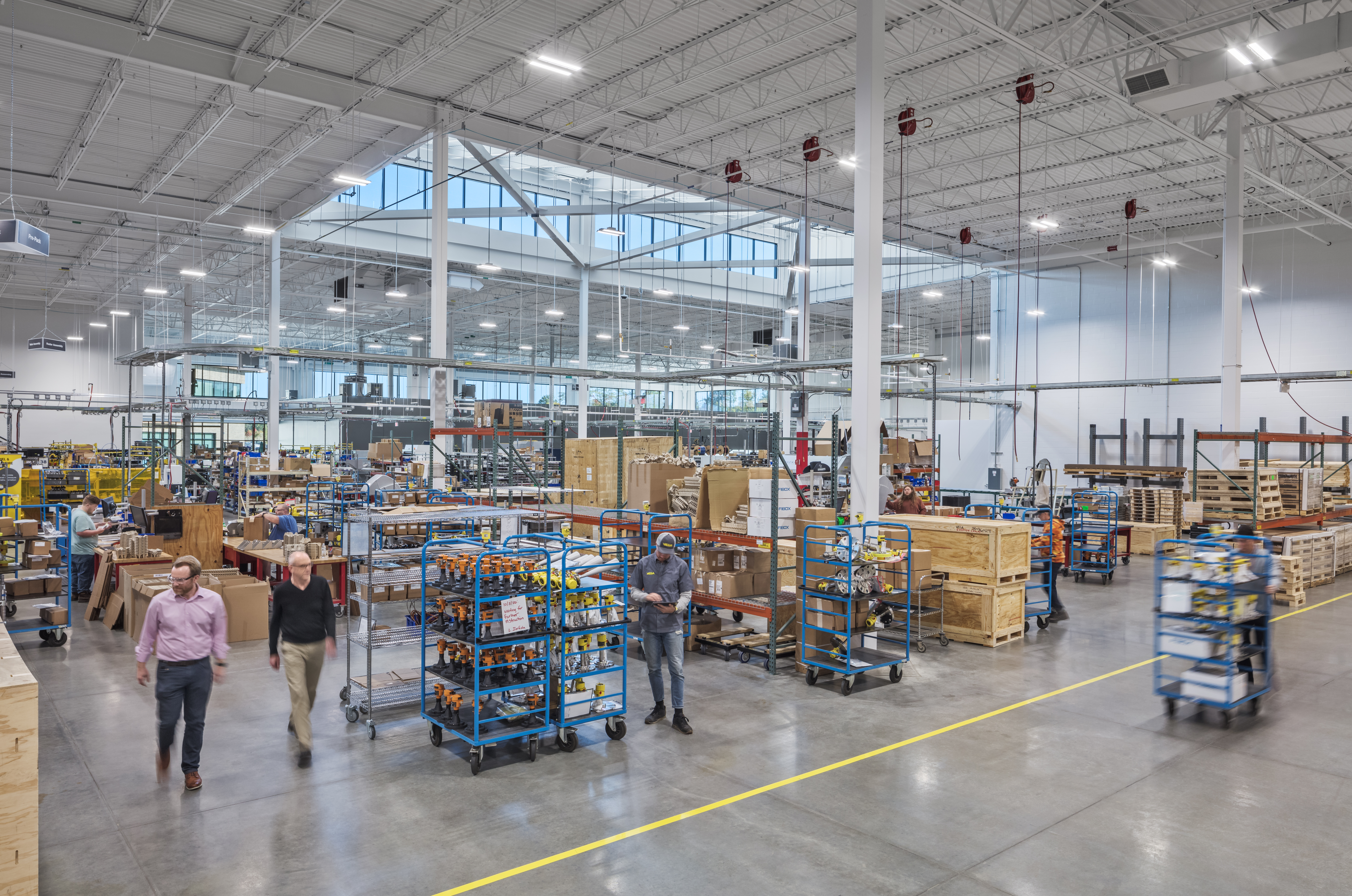

A facility’s design reflects how it values its people. Companies can communicate to employees that they value their contribution and well-being with energizing surroundings and attractive amenities. A study by Future Workplace, a research and advisory firm, found that employees prize natural light and a view of the outdoors more than other perks like cafeterias and fitness centers. Additionally, inadequate ventilation is connected to poor concentration and increased employee absenteeism. Good air quality and natural lighting are critical to protecting employee health and well-being. Whether consciously or not, employees in a healthy workplace feel more motivated and loyal because they enjoy their work environment and feel good there.

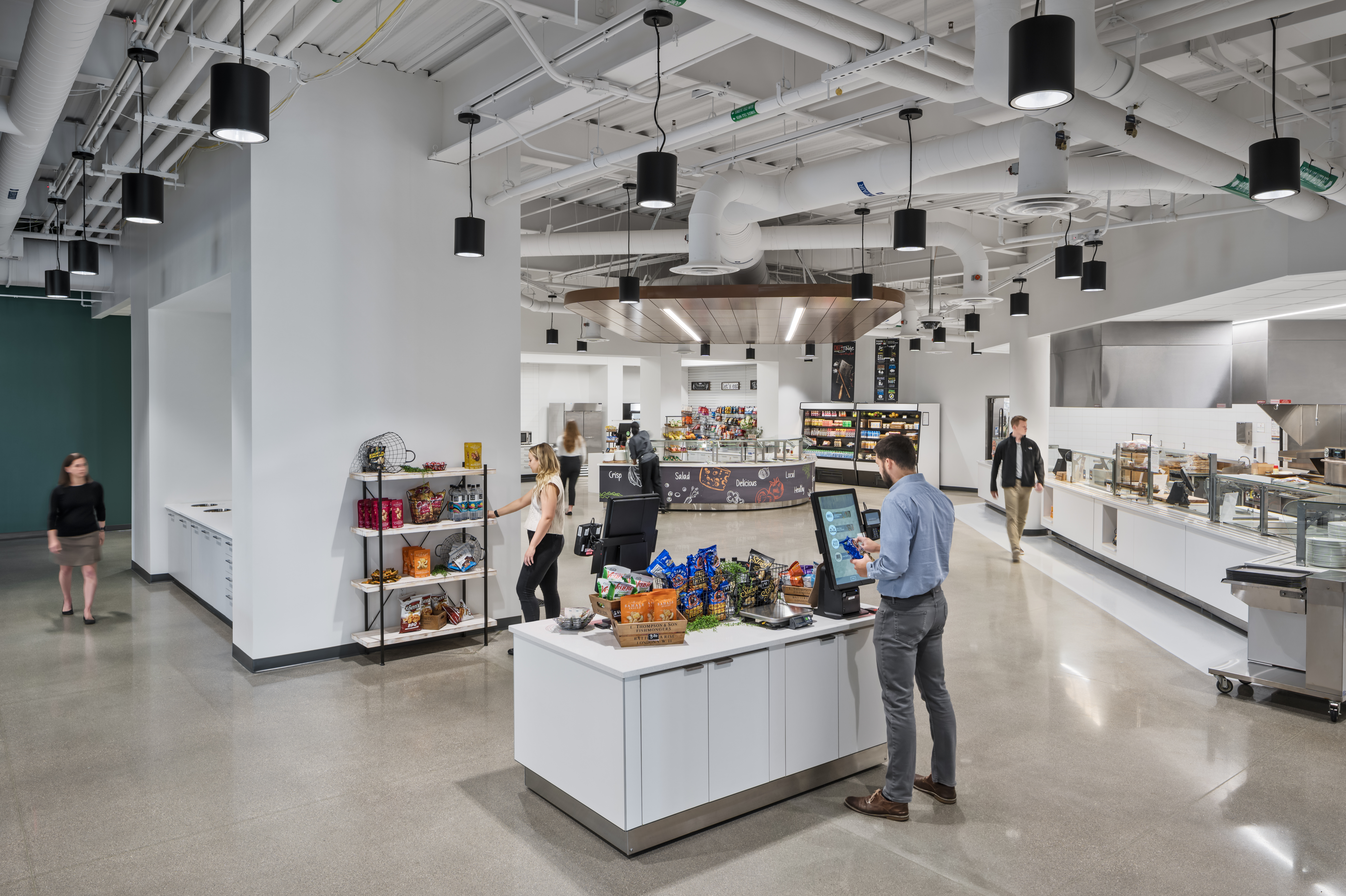

Cafeterias, break rooms and restrooms aren’t afterthoughts in a facility concerned with the employee experience. They should be comfortable spaces that all employees can easily access. Break areas and cafeterias should provide employees with a genuine respite from their work. Instead of inundating them with company branding and work messages that create visual noise, these areas should offer a calm, uncluttered environment that allows workers to recharge during breaks. Empowering employees to disconnect entirely from their work environment during breaks has been shown to lower their stress levels and combat fatigue. Workers who feel less stressed or tired are less likely to get burned out. Avoiding burnout improves retention rates. Workers who feel burned out “are nearly three times more likely to be actively searching for another job.”

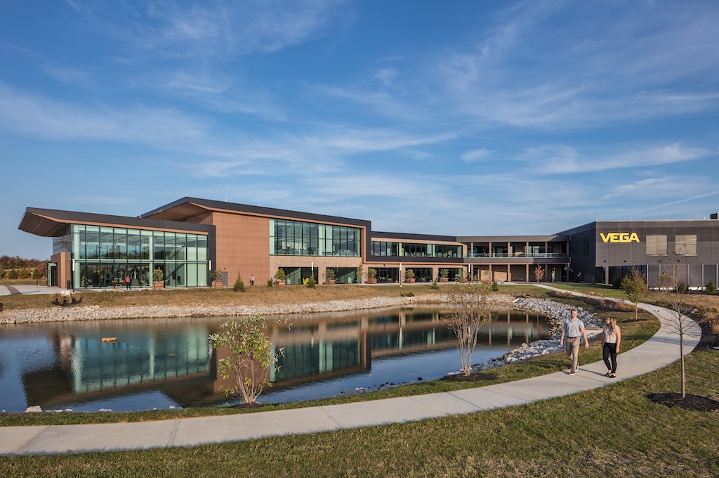

Biophilia or a connection with nature is an increasingly prized touchstone. This could mean indoor plants, outdoor seating areas, views of landscaped grounds or even hiking trails for an industrial facility. These features help employees relax and refresh and have been shown to reduce absenteeism and improve engagement.
A well-designed facility offers multiple strategically placed outdoor spaces. If there’s only one outdoor seating area, it often becomes the smokers’ corner. Areas near trash bins, loading docks or other staging areas won’t fulfill this purpose for employees either. VEGA Americas, a process instrumentation manufacturer, designed its new research and development park, including a 129,000-square-foot advanced manufacturing facility with considerable natural light, large windows, viewable and walkable landscapes and quality employee spaces. Once it moved into the new building, the company saw its employee retention rate jump to over 90% from the mid-1970s 70% range in the older facility.

Existing workplace environments can be improved. Many employee-friendly elements don’t have to wait for a major renovation or a new build. Lighting fixtures can be cleaned or upgraded to modern LED systems that provide a more natural light quality. A light color will brighten the entire space if the floor needs a new epoxy coat. Even painting the walls bright white is a quick win that will liven up the manufacturing floor. HR can identify areas with the most complaints so companies and designers can target the changes with the greatest impact.
