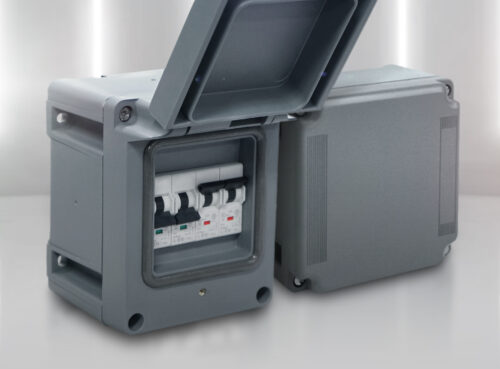

High-performance plastic junction boxes for demanding environments
The TM Series plastic junction boxes, compliant with the international standard IEC 60670, ensure strict adherence to quality and safety regulations. The housing is made of halogen-free thermoplastic and comes in a gray RAL 7012 color to blend in with various environments. They feature 5 mm thick enclosure walls with surface indentations to help end users position and punch holes.

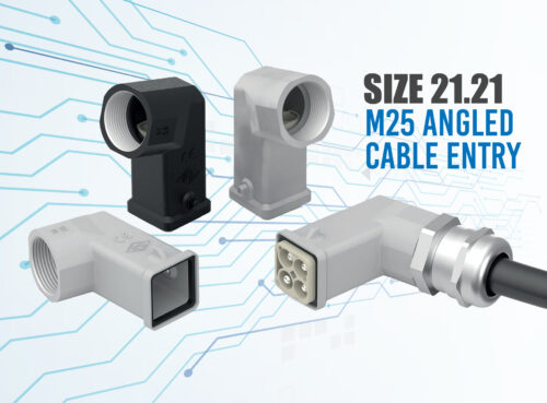

Size 21.21 metal hoods with M25 angled cable entry
The wide range of 21.21 rectangular connectors offers a number of advantages for modern industrial applications. They provide a secure and reliable connection for power and signal transmission, with high resistance to environmental factors such as dust, moisture, and vibration. In addition, their compact design allows for easy installation and maintenance, making them a popular choice for a wide range of industrial machinery and equipment. The new size 21.21 metal hood with angled M25 cable entry can accommodate large-diameter cables or wire bundles while eliminating torsional stress on the locking lever of the mating enclosure.

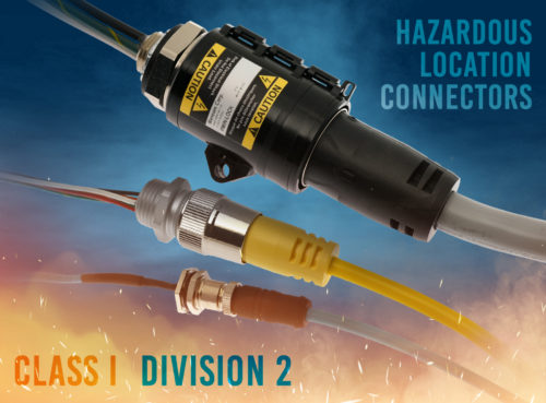

Hazardous Location Connectors
Mencom Hazardous Location Connectors series is designed to meet stringent electrical requirements for protection under Class I Division 2 environments and certified by Underwriters' Laboratories (UL). ‘Class I’ is defined as a hazardous location in which flammable gas or vapor may be present in sufficient quantities to be considered ignitable or explosive. ‘Division 2’ is defined as an area that is not likely to contain dangerous concentrations of flammable substances in closed containers.

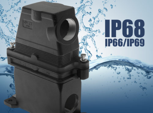

IP68 Enclosures
Mencom offers a range of IP68 series rectangular enclosures that provide the highest level of protection against dust and complete continuous submersion in water. These IP68 series enclosures have also successfully passed the tests required for the IPX6 degree of protection (tightness to powerful water jets) and for the IPX9 degree of protection (high pressure and temperature water jets), thanks to the dual O-ring seal design. Therefore, their official overall protection rating is IP66/IP68/IP69.The IP68 enclosures except size 44.27 are made of corrosion-proof foundry grade aluminum alloy and they are coated with oven-cured thermosetting paint with epoxy power, which makes the enclosures highly resistant to scratch, shock, seawater, and chemicals.
