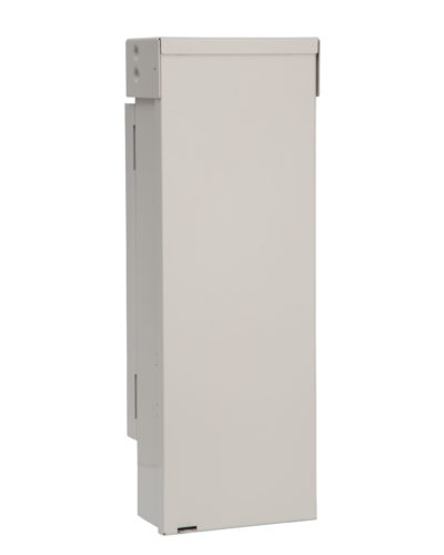

RP450 Power System
ABB Power Conversion is helping to energize the rollout of 5G repeaters with solutions like its new RP450 power system. The all-in-one solution meets the power density, footprint, and availability needs of 5G repeaters, helping to extend network coverage. The pole-mounted RP450 power system is specifically designed for 5G repeater application, with its integrated design housing a rectifier, distribution equipment, a surge protector, and a service-entrance-rated AC input breaker within a single enclosure.
