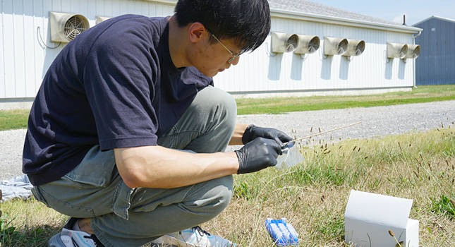

Lab-based assays often involve collecting and washing leaves, then sending them to a lab. At first, Verma’s team swabbed lettuce leaves to see if they held any contaminants. But the grooves in the leaves foiled that sampling method.
Then the team’s industrial partners suggested a simple fix. The researchers now use plastic sheets to collect whatever happens to land on them. These “collection flags” provide easily repeatable results along with location data. The flags can be planted in particular locations with unique identifiers.
“Do the assay on each flag, and then you have spatial data,” Verma said.
