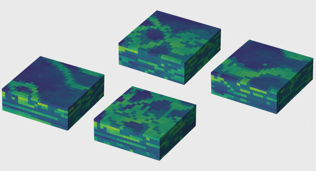

Color-coded models from algorithms trained by graduate researchers at Texas A&M University are boosting industry confidence in using machine-learning techniques to depict oil and gas resources hidden in the Earth’s subsurface.
Color-coded models from algorithms trained by graduate researchers at Texas A&M University are boosting industry confidence in using machine-learning techniques to depict oil and gas resources hidden in the Earth’s subsurface. Courtesy: Siddharth Misra
