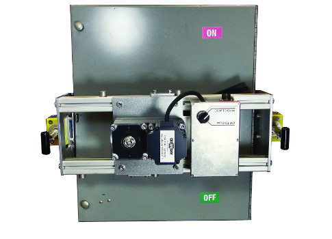

The RSA-154F remote switch actuator allows technicians to remotely close or open the switches from a safe distance while remaining stationed outside the arc-flash boundary.
By CBS ArcSafe July 21, 2015
The RSA-154F remote switch actuator allows technicians to remotely close or open the switches from a safe distance while remaining stationed outside the arc-flash boundary. CBS ArcSafeThe RSA-154F remote switch actuator allows technicians to remotely close or open the switches from a safe distance while remaining stationed outside the arc-flash boundary. Installation and operation does not require any modifications to the existing electrical equipment. The RSA-154F is compatible with all type VF357, VB357, VF358, and VB358 Vacu-Break panel switches with a 25” height and ratings from 800-1200A. Typical applications of these switches include manufacturing plants, mass-production industries, and commercial, institutional, and other large buildings served by network systems or transformers of higher capacities.
