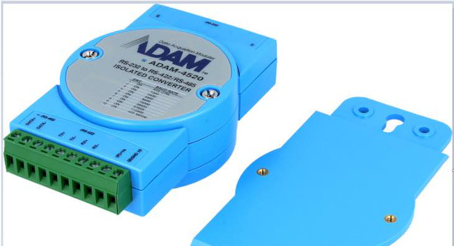

Enabling convenient communication among equipment supporting different serial interface standards, the Advantech ADAM-4520-F is an RS-232 to RS-422/RS-485 converter module capable of delivering 115.2kbps data rates. By attaching one of these units to equipment that was originally fitted with RS-232 interfacing, it is possible to convert the RS-232 signals into isolated RS-422 or RS485 signals. Through its use, communication distances of up to 1200m can be supported and as many as 32 nodes connected. There is no need to change software, thereby facilitating the upgrade process. As well as having 3kV galvanic isolation, this module has a built-in surge protection mechanism. An operational temperature range of -10 to 70°C is covered. Supplied in a compact ABS enclosure (with 70mm x 122mm x 30mm dimensions) it can be DIN-rail or panel mounted.
