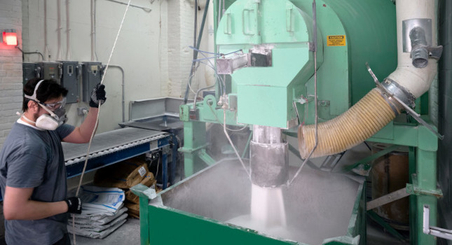

At the end of the cycle, the operator flips a switch, actuating an air cylinder that opens the mixer’s stationary outlet. With the vessel continuing to rotate, the 1,000 lb. batch discharges through a collapsible chute into a mobile bin. Dust collection pickups are located at the mixer’s outlet, at the screw conveyor’s discharge and at the bag breaking station. The mixer itself operates dust-tight with a single radial seal preventing dust leakage.

The mixer discharges uniformly blended product into a mobile bin, which is wheeled to low-pressure extruders and the hot-melt casting process. Dust is collected during discharge.
The mixer discharges uniformly blended product into a mobile bin, which is wheeled to low-pressure extruders and the hot-melt casting process. Dust is collected during discharge. Courtesy: Munson Machinery.
