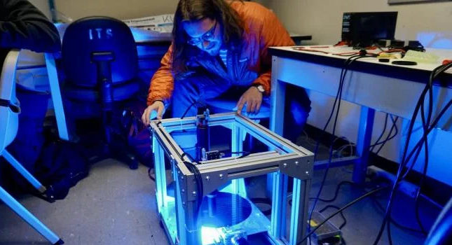

Marty LaRocque looks over the team's silicon wafer center-finding improvement device. Courtesy: Colorado University.

The Department of Mechanical Engineering seniors have built a silicon wafer center-finding improvement device for KLA, a semiconductor manufacturing company. The Senior Design team’s prototype uses two cameras to capture the circular wafer’s edge, plus computer software to calculate the radius and find the wafer’s center.

Currently, KLA is detecting the wafer’s center with ten different images around the edge. The team of students designed their device to find the center just as efficiently with only two images.
“On one of KLA’s inspection tools, it currently takes them eight seconds to align one wafer, and we’re trying to get that down to two seconds,” said Project Manager Jack Carver. “A 75% reduction is going to get so much more throughput. With the global silicon wafer supply shortage, any improvements in that would be greatly beneficial for them.”

The team captured their first position of the wafer’s center in early March. They are now running statistical tests and taking measurements to check the device’s accuracy. They need the coordinates to be within 10 microns of the true center, which is the width of a human red blood cell.
The device uses two cameras to capture the wafer's edge. Courtesy: Colorado University.
The device uses two cameras to capture the wafer’s edge. Courtesy: Colorado University.
