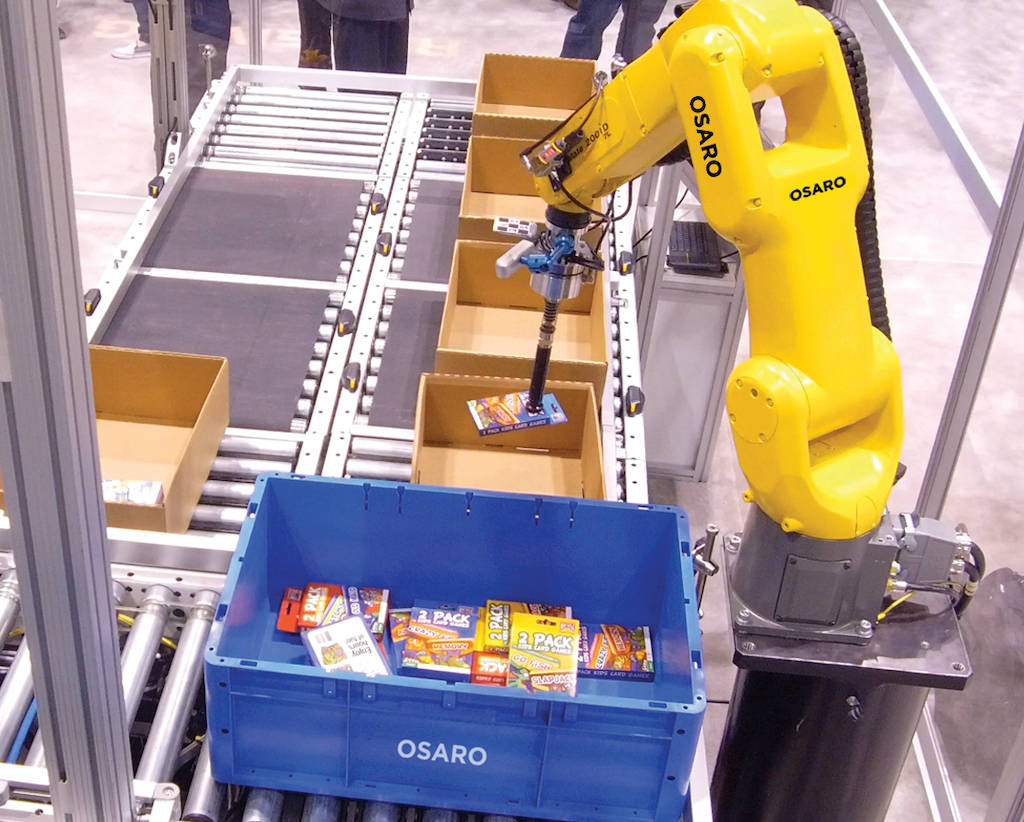

A robot powered by OSARO’s machine learning system picks consumer goods. Courtesy: A3/OSARO

Traditional industrial automation systems are not intelligent enough to adjust to variation in the environment, a major impediment when it comes to complex material handling tasks, said Derik Pridmore, co-founder and CEO at OSARO, a machine learning company focused on robot vision in industrial and warehouse automation applications.
“Instead of a robot performing the same task 5 million times, our customers want robots to do something slightly different each of 5 million times, for example in material handling applications running on conveyors. You need artificial intelligence to do that,” Pridmore said.
The OSARO system applies machine learning to visual information about the environment and robot actions. By relating that visual data to a robot’s position and applying machine learning algorithms, robots can be trained to move and grasp objects more efficiently, optimizing performance and improving the bottom line for owner-operators. This involves periodic movement of data through cloud infrastructure, which is “extremely well-developed and sophisticated.”
GDPR is a set of tough data protection laws developed by the European Union designed to ensure data privacy and security. The OSARO solution is GDPR-compliant, said Pridmore, which means that customers can, for example, request that any personal data collected by OSARO at any time can be retrieved and deleted.
Owner-operators can also request that their data is not used in OSARO’s machine learning models, however this is yet to happen, as it defeats the purpose of investing in AI in the first place. “No one has ever done that, because the whole point of gathering and processing visual data is that you want your robots to learn,” Pridmore said.
