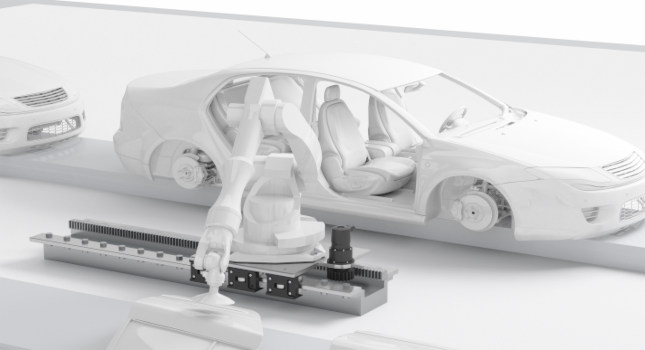

A robotics application for the automotive industry. Courtesy of: Schneeberger Inc.
In large automation systems, there are times when the design engineer must transfer components with very large axial forces across long linear ranges of travel. These requirements are typically found in applications such as industrial automation and robotics, machine tools and packaging machinery.
While there are several movement options the design engineer can choose – ball screws, linear motors and drive belts, to name a few – gear racks are extremely economical when the needed stroke is more than 4 meters. They permit linear movement that can extend along almost limitless stretches, making them well suited for large machines and systems. Gear racks’ simplicity and strength enable easy customization, giving the engineer attractive flexibility in designing a linear movement system.
