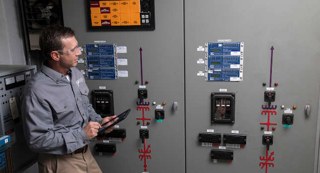

Figure 1: Before and after the protection relay upgrade. Courtesy: High Voltage Maintenance

A semiconductor manufacturing facility was experiencing challenges with its switchgear control system. The facility had two medium-voltage utility feeds. The original switchgear, which dated back to the 1970s, contained an auto throwover (ATO) control scheme to operate the main-tie/main breaker and maintain power to the switchgear if one of the utility sources is lost. The vintage ATO was comprised of control relays, voltage relays, timers, resistors, capacitors and a significant amount of wiring. The parts for this vintage system are now obsolete and no longer supported by the manufacturer, thus a repair to the system would be difficult and slow, resulting in an extended and possibly unplanned outage (see Figure 1).
The High Voltage Maintenance (HVM) team performed an engineering evaluation to assess the system and make recommendations for a path forward. The protection relays were an original electromechanical overcurrent relay style, and even though they had been properly maintained throughout the years, HVM developed a solution that would use the relays in conjunction with a logic processor to act as the new ATO control system. This design took advantage of the communications, individual relay element functions and configurable internal logic within the relays to work in tandem with a separate logic controller to function as the ATO. The new relays also took over the circuit protection role.

Field Installation, functional testing and startup. Once delivered to the site, the field wiring and components required for field installation are completed according to the installation drawings. All wires are marked at the terminal strips. Any field-installed component testing was then completed along with point-to-point wire checks. A functional test plan was developed, and the complete system was tested against the plan to ensure proper operation (see Figure 2). The last phase of the project required the lead test technician to be onsite during startup to verify phasing, download advanced relay waveforms, set event parameters, and so on, and everything is documented on the final project report.
