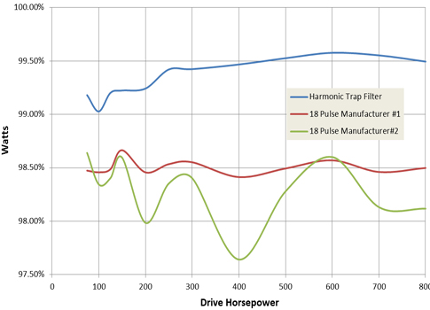

The watts loss of this type of filter can be 2% to 3% of the load, and it can cost ten times the price of a line reactor. Tuned harmonic traps can alter the natural resonant frequency of the power system and may cause system resonance. They may attract harmonics from other nonlinear loads sharing the same power source and must be increased in capacity to accommodate the addition of new loads. For best results, a power system study should be performed to determine the magnitude of harmonics to be filtered (from all loads), the power system resonant frequency, and the impact of future addition of loads.

Because of differences in the transformer secondary impedances and open circuit output voltages, this can be practically accomplished for a given load (typically rated load) but not over a range in loads. The performance of 12-pulse systems does not hold up well under a line imbalance. Typical losses of a 12-pulse transformer are 3% to 5% of the transformer KVA rating. Note that the extra diodes and transformer windings will add significant cost to the system.

The 18-pulse rectifiers also experience diminishing performance when line voltages are not balanced, and when operating at less than full load. An 18-pulse drive may offer guaranteed harmonic distortion levels, but typically only at full load and full speed conditions, with voltages that are balanced within 1%. The effect of unbalanced voltages is that as the load is decreased, the magnitude harmonic distortion increases significantly. While THID at full load may be fairly low, at 40% load, harmonic current distortion can be over 20% THID, when the line voltages were only 1% unbalanced. With 3% imbalance the harmonic current distortion increases to over 40% THID. To enhance the performance of 18-pulse drives, line reactors can be added in series with the individual bridge rectifiers.

Traditionally thought of as the bulletproof solution, multi-pulse converters provide good harmonic performance of about 4% to 6% THID under a controlled range of conditions for imbalance and loading. However, multi-pulse solutions are often very costly and take up significant real estate. They are also generally the least efficient, adding as much as 1.5% to 2% losses to the system.
Passive filters are readily available and can be fitted to standard 6-pulse drives yielding harmonic mitigation levels of less than 5% THID. Some newer passive filter designs now employ technology that allows the filters to perform well under imbalanced conditions and at much lighter loads than multi-pulse solutions. The passive filter will have lower power losses and typically be much smaller and lower cost than the multi-pulse.
