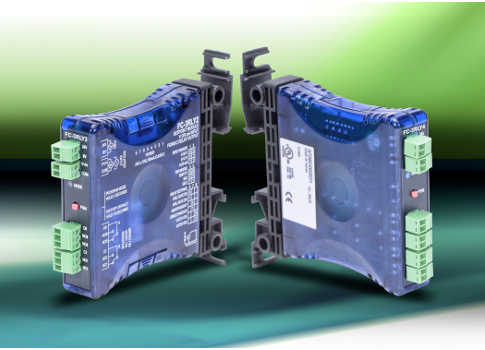

AutomationDirect’s new FC-series analog to relay limit alarm modules are field configurable for a variety of alarm and control applications.
AutomationDirect’s new FC-series analog to relay limit alarm modules are field configurable for a variety of alarm and control applications. Modules are available with two or four SPDT relay outputs, can be powered by 24 VAC or 24 VDC, and accept input signals of 0-15 V, 0-30 V, or 0-20 mA. Configuration and trip/release point programming is accomplished with DIP Switches, and a single programming pushbutton. LED’s provide indication of operating status and are used during the trip/release point programming.
