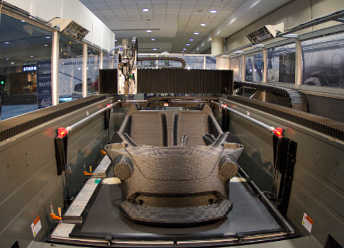

Local Motors is a collaborative auto design shop on the cutting edge of the 3D revolution. The company, with operations in Phoenix, Las Vegas, and Knoxville, Tenn., brought its 3D expertise to the 2014 IMTS Show in Chicago to print an entire car from front to back during the six days of the show. On the final day of the show, Local Motors CEO Jay Rogers and Association for Manufacturing Technology CEO Doug Woods drove the finished car out of McCormick Place.
The work leading up to that event highlights the leaps additive manufacturing is making. “There are a lot of kinks that have to be figured out,” said Justin Fishkin, chief strategy officer for Local Motors. “We didn’t even know we wanted to 3D print a car at the show. When we first started to print a large-scale unibody for the car, it took 180 hours. When we got to Chicago, it was down to 44 hours. That’s a huge efficiency.”
