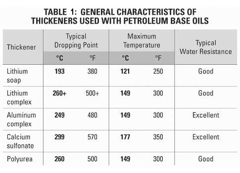

Grease lubrication is generally applicable to low- to moderate-speed applications that have operating temperatures within the limits of the grease. There is no universal anti-friction bearing grease. Each grease has limiting properties and characteristics.
Greases consist of a base oil, a thickening agent and additives. Conventionally, bearing greases have consisted of petroleum base oils thickened to the desired consistency by some form of metallic soap. More recently, synthetic base oils have been used with organic and inorganic thickeners.
Using polyurea as a thickener for lubricating fluids is one of the most significant lubrication developments in more than 30 years. Polyurea grease performance is outstanding in a wide range of bearing applications and, in a relatively short time, it has gained acceptance as a factory-packed lubricant for ball bearings.
Low temperatures
Starting torque in a grease-lubricated bearing at low temperatures can be critical. Some greases may function adequately as long as the bearing is operating, but resistance to initial movement may be excessive. In certain smaller machines, starting may be impossible when very cold. Under such operating circumstances, greases containing low-temperature oils generally are required if the operating temperature range is wide.
Calcium- and aluminum-based greases have excellent water resistance and are used in industrial applications where water ingress is an issue. Lithium-based greases are multipurpose and are used in industrial applications and wheel bearings.
Synthetic base oils, such as esters, organic esters and silicones, used with conventional thickeners and additives typically have higher maximum operating temperatures than petroleum-based greases. Synthetic greases can be designed to operate in temperatures from -73 C (-100 F) to 288 C (550 F).
An important point concerning lubricating greases is that the starting torque is not necessarily a function of the consistency or the channel properties of the grease. Starting torque is more a function of the individual rheological properties of particular grease and is best evaluated by application experience.
High temperatures
The high temperature limit for lubricating greases is generally a function of the thermal and oxidation stability of the fluid and the effectiveness of the oxidation inhibitors. Grease temperature ranges are defined by both the dropping point of the grease thickener and the composition of the base oil.
A rule of thumb, developed from years of testing grease-lubricated bearings, indicates that grease life is halved for every 10 C (50 F) increase in temperature. For example, if a particular grease provides 2,000 hours of life at 90 C (194 F), by raising the temperature to 100 C (212 F), reduction in life to approximately 1,000 hours would result. On the other hand, 4,000 hours could be expected by lowering the temperature to 80 C (176 F).
Thermal stability, oxidation resistance and temperature limitations must be considered when selecting greases for high-temperature applications. In non-relubricatable applications, highly refined mineral oils or chemically stable synthetic fluids are required as the oil component of greases for operation at temperatures above 121 C (250 F).
